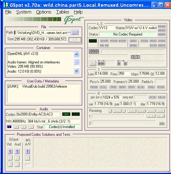

On the surface, the AC3 input plug-in appears to be working... but the resultant remuxed AVI contains no data in the audio stream.
I can't tell if this is an issue with VirtualDub or the input filter, but I'm hoping someone with a lot more experience can look @ this for me.
What I'm trying to do atm is a simple test. I have 350 frames worth of uncompressed video stream, and the corresponding AC3 audio stream saved in two separate files.
What I want to do is open the video stream in v-dub (no problem) and then remux the AC3 stream in, leaving the video untouched (just for this test).
To do this I concluded that the AC3 input plugin was the solution. Unfortunately, it all appears to work in the GUI, but the resulting file contains headers for an audio stream, but no data in the stream. See a pic here: Gspot-pic.jpg
FWIW, I put the input filter plug-in into its proper directory (plugins32) and I can tell Virtual Dub is using it because it adds *.ac3 to the file selection mask list, and I can also get an error out of the plug-in (more on that later).
I tried switching to Full Processing Audio mode and ran another test dumping the decoded output as PCM audio (and of course the file should have gotten a lot bigger) but the file size only grew by 66KB.
I also went as far as installing the AC-3 ACM codec (which looks sweet) to try a cheap 1:1 recompress @ the same bit rate, etc., but that file operation failed with the message, 'Error initializing the audio stream compression: <snip>' which I can't blame it for throwing, given I suspect there was no input to be compressed.
