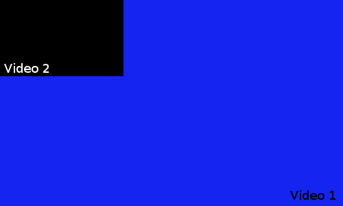

I recorded two videos today and now I'd like to know, if and how it's possible to open two videos at the same time, so that one video is played at the same time, only smaller and in one corner of the other one.
Here's an example of what I have in mind here:
http://www.qpic.ws/images/vdubvideooverlayzuz.png
Of course, they need to be merged together later.
Thanks in advance!

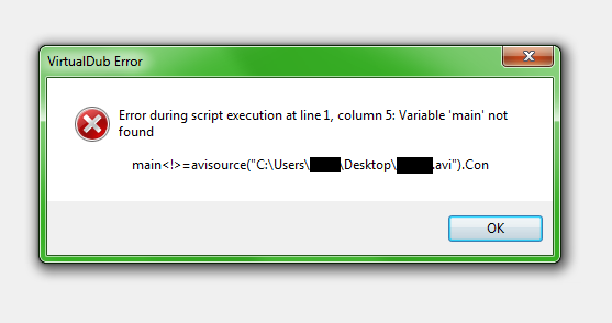

Sorry for the big delay, but I couldn't find any time to try out the script. Now, I tried malky's way, but I'm getting the following error message:

Malky assumed some basic knowledge of Avisynth
* install Avisynth
* in Malky's code, substitute your video paths for the ones in the script
* save code as: plain text, named <something>.avs ("<something>" can be any file name)
* Virtualdub File menu, open, <something>.avs
PS of course you won't get another error, but if you do:
View menu, Log, right-click, Copy
(instead of a screen shot)
