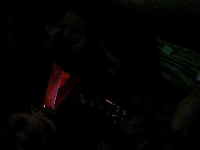

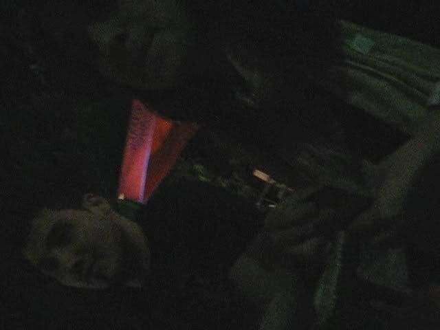

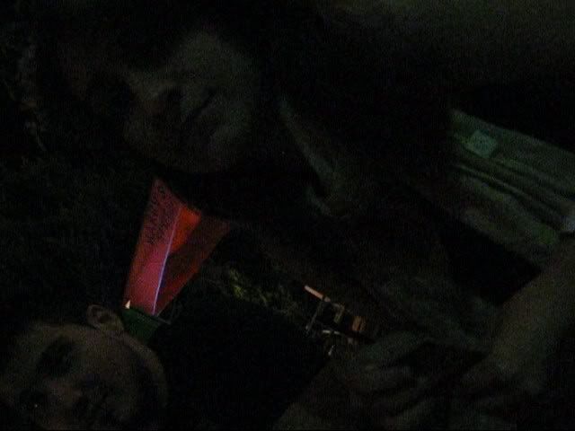

I have been using VirtualDub to recompress my digital camera's mjpeg-videos to manageable sizes, and in the past year it's been very helpful. But lately I've began taking videos under very low-lighting and it seems that after the compression, the images become darkened -and thus distorted- much more than the original! And what's weirding me out is, it is INDEPENDANT on the codec used - it even happens without using any codec! In the meanwhile, all videos I edit in good/medium lighting have no such problems.
Below are three screencaps so you can understand the problem (click on the links below to see them).
Original video
Compressed without using any codec
Compressed using pretty much any codec
As you can see the image becomes so dark that details on the faces are lost, and the eyes look downright eerie. Can anyone tell me how to compress the video and have it look exactly as it appears in the original?

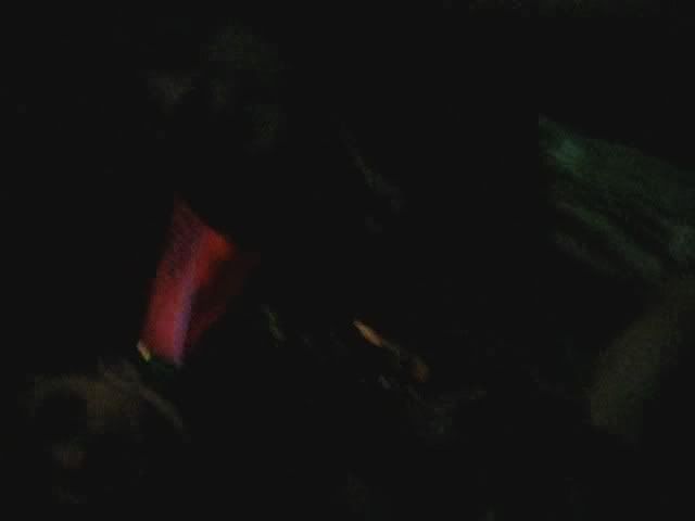

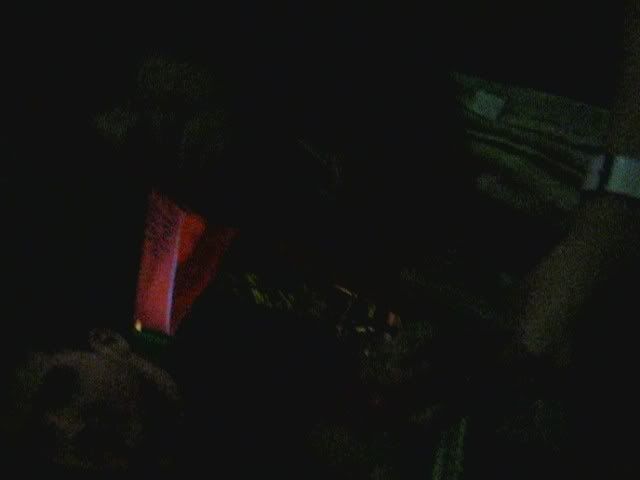

Actually, it probably is a luma range issue, although it's weird that the compressed/uncompressed images would vary so widely. Try switching input and output formats to YUY2 and see if it makes a difference in the uncompressed version; if so, you've got a luma range problem.
AdventurerGR
Posted: Jun 9 2008, 12:10 PM
Newbie
Posts: 3
Member No.: 23695
Joined: 8-June 08
Thanks a lot Phaeron. Although even YUY2 didn't work (screenshot here) you got me thinking on the color issue, and I put 16-bit as input color and it worked (screenshot here)! I don't know why that happened (maybe an issue with my Canon Powershot A710 camera?) but I got the solution now and hopefully if anyone has the same problem they'll find their way in this thread and also see it.
