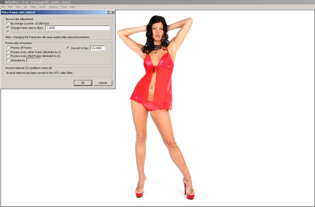

Depends on how slow or how fast you want the animation to play. If you want each frame to show for 10 seconds then set it to .1000, 5 seconds .5000, 1 second 1.000, 1/2 second 5.000.
Use the top field to change the speed and the lower field to change amout of frames.
EXAMPLE:
The slower you you want the animation the lower you set the source framerate.
Not sure what you mean in your original post when you say you're having problems with slow playback since default 10fps is superfast for single frames of an animation. You are viewing 10 different pictures in one second. By changing from 10fps to 500fps means you would 500 different pictures in one second. I assume that you meant just the opposite, that you couldn't get it to play slower. To do that, you would need to lower the fps, not increase it.
